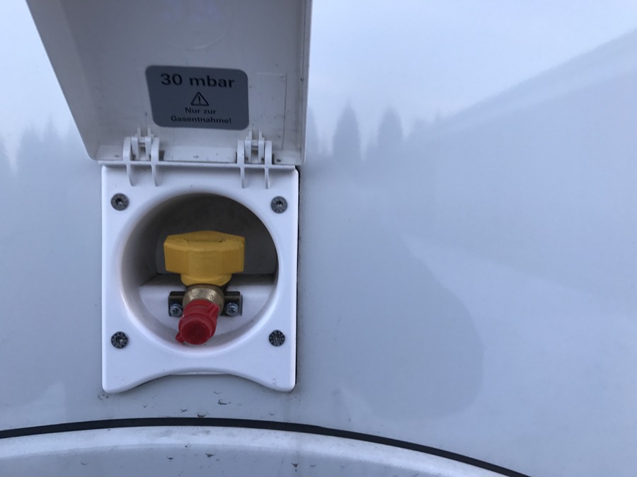

Demesio! Savininkai kurie turi sumontave duju voztuvus
Gavau laiska, kuriame nurodoma, kad 2016 metais pagaminti duju kranai ir voztuvai gali praleisti dujas. Praso pasitikrinti serijos numerius pas atstovus. Originalus laiskas: With some gas sockets from the company Truma and valves of the company GOK with articles with Art-Nr. 9993038, 9910784, 9998244 as well as GOK articles 9933030, 9952472, 9933040 and 9952473 It can lead to a leakage and under unfavorable circumstances to a gas depletion and injuries.Both suppliers are articles with coding from 01.2016 to 01.2017.Only specific batches are affected. For further information, please refer to the enclosed information leaflets of Truma and GOK.We would ask you to inform your customers and draw your attention to the precautions.Please also check your stock!A possible exchange of the affected articles takes place within the framework of the usual guarantee process.
For more detailed information on already installed Truma gas digesters follow.
Pas mane yra pavyzdys kaip paziureti numerius. Tai galioja tokiems ir panasiems kranams:

O kur galima pažiūrėti Nr? Aš kaip tik GOK-ą praeitą žiemą instaliavausi.
Parašyta: 2017-02-10 08:34:50
Atsiusk i privata man savo el. pasta, persiusiu Tau visa laiska, ten yra parodyta. Bet man sake kad jei metai atitinka tai keicia tada.
